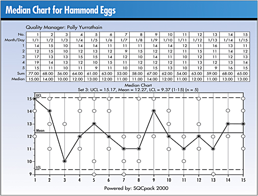

She suddenly recalls the use of median charts, popularized by Paul Clifford after World War II, where only the median is recorded rather than the mean. Common practice called for sample sizes of three or five, so no math was necessary. For example:
Data: 14, 12, 17, 19, 15
To calculate the median, the data must be ordered from the smallest to the largest number; the middle number is the median. In this example, it would be 15.
Excited by this approach, Yurrathain teaches her motley crew how to do median charts, beginning with the following formula:

The real reason that control limits are about 25 percent wider than for X-bar and R charts deals with the difference in the way medians and averages are calculated.
The mean uses all the data in a sample to estimate the central location of the population.
The median orders the samples from smallest to largest and picks the middle number (assuming an odd sample size) as an estimate of the central location of the population. With a sample size of five, all data values are used in calculating the mean, but only one number is used to determine the median’s value. It’s as if the calculation of the median throws away the information in four of the five pieces of data. One would expect that the mean would be a more efficient estimator of central location of a population than would a median. (Note: An “efficient” estimator is one that is more precise in its ability to estimate a population parameter.)
Statistician Walter Shewhart was aware of the phenomenon and noted that the sampling distribution of sample medians will be about 25 percent more variable than the distribution of sample means. (Source: Shewhart, W.A. Economic Control of Quality of Manufactured Product [D. Van Nostrand, 1931])
