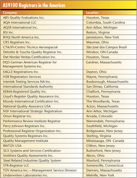

In the Americas, 32 registrars are approved for AS9100. They are listed in the table below.

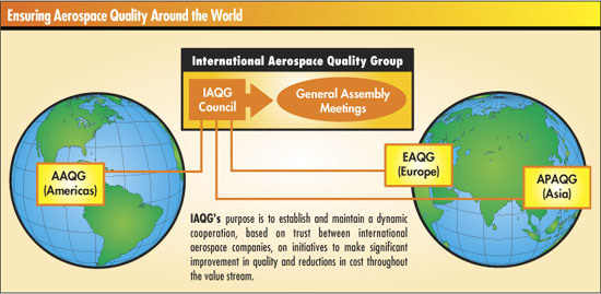

Three sectors, one voice
Much effort has been made to ensure that AS9100 requirements are accepted and adopted not only by U.S. aerospace OEMs and primes but also by their counterparts in Europe, South America and Asia.
In order to accomplish this, three aerospace sectors were created around the world to allow the industry to speak with a single voice to its global supplier base: the Americas Aerospace Quality Group, the European Aerospace Quality Group and the Asia Pacific Aerospace Quality Group. Together, these sector schemes compose the International Aerospace Quality Group. Each group determines the standards bodies responsible for controlling their respective documents. In the Americas, SAE performs this task; in Europe, it’s the AECMA; and in Asia Pacific, SJAC maintains the documents.
For more information about the IAQG and AAQG, visit the organizations’ respective Web sites at www.iaqg.org and www.sae.org/aaqg.
