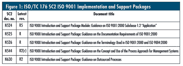

The table in figure 1 lists the SC2 implementation and support packages currently available. You can download Microsoft Word versions at www.iso.org/tc176/sc2. In addition to the downloads in English, links are provided for versions in French, German, Italian, Japanese and Spanish. Note that the packages are subject to revisions to improve their usefulness, so a periodic check of the site for updates may be useful.

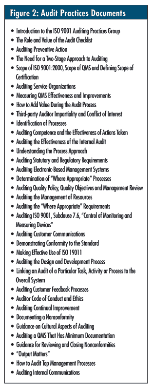

Also available are the audit practices documents listed in figure 2. These are available for downloading or viewing by clicking the “ISO 9001 Auditing Practices Group” link at www.iso.org/tc176/sc2. At the bottom of the page, you can click on “Zip file of all the above documents” and get the whole group in a 3 MB package.
These were created by the ISO 9001 Auditing Practices Group, an informal group of quality management system experts, auditors and practitioners. Members of the group are drawn from ISO/TC 176 and the International Accreditation Forum.
