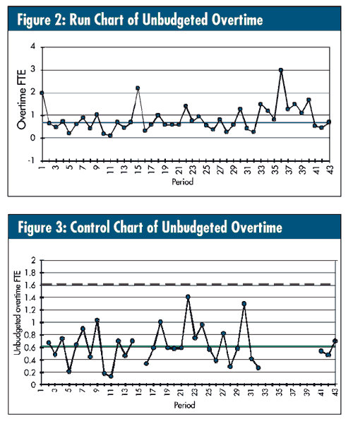

At the same organization, I had another friend who used to get routinely beaten up because of her unbudgeted overtime. She gave me 42 unwieldy biweekly tabular reports, from which I took this number from the last page and plotted the run chart seen in figure 2.
The peaks correspond to periods with Monday holidays. So, she was already over budget right from the start! As her year-to-date figure inevitably improved, Memorial Day weekend hit… and then the 4th of July… and then Labor Day….
She’s perfectly designed to have excessive overtime during a period with a Monday holiday. For now, these should be plotted and dealt with separately.
Then there’s the period of eight-in-a-row toward the end. I asked her what went on during this period. She had two receptionists quit, and replacements were hired at the end. This person was a very good manager. If employee turnover had been a consistent process problem, there would be no such signal, the average would be higher and the variation would be wider.
Eliminating these special causes resulted in the control chart seen in figure 3.
She’s perfectly designed to have 0.63 FTE overtime routinely--even though she’s not supposed to. From the lower limit, there will eventually be a pay period where she doesn’t have any overtime, and she’ll be told, “Well, you did it that month, so do it every month.” Might a matrix analysis of where the overtime budget dollars go--for all of these stable periods aggregated together--be useful?
