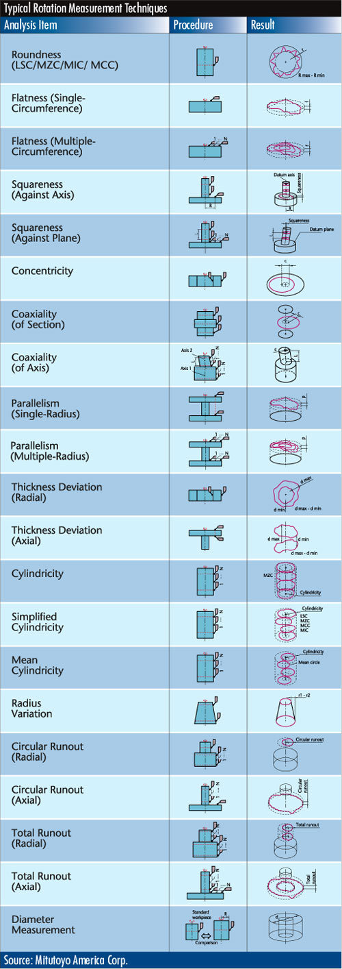

Roundness testing systems are often referred to as form measurement systems because of the several part features they're capable of measuring. Along with roundness, today's roundness testing systems are equipped to measure runout, coaxiality, flatness, squareness, concentricity, cylindricity, parallelism and perpendicularity, among other things (See the chart below).
