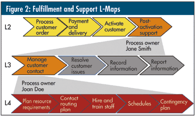

Organizations that take process excellence seriously will identify owners for each process on the L1-map. Although the process owners’ duties and authority vary from one organization to the next, there are some common features. Process owners are responsible for defining their process in detail, establishing performance measures, and working with functional managers to achieve process excellence. This can be accomplished utilizing fulfillment and support L-maps, as seen in figure 2.
At some level the L-mapped process will become "actionable." This simply means that at this level a process owner will be able to determine how to improve the process. Improvement might involve Six Sigma projects or some other method of improvement, such as a traditional project, continuous improvement, or local work-group activities. For Joan Doe, her process map provided the guidance she needed to identify her process- improvement strategies.
Note that figures 1 and 2 drill down only along a single path for each level. The entire set of L-maps that define all of the top-level processes can be quite large at the L4 level. Consequently, a company’s top leaders will need to develop reporting systems that focus their attention on the vital improvement projects and activities that deploy their strategies and implement their goals.
