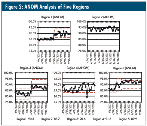

To demonstrate this in a fashion that more accurately reflects the philosophy of ANOM and takes care of region 4’s variation problem, the five graphs in figure 2 are once again on the same scale as last month; however, what I’ve done is to compare their most recent stable performance to the average of the other four regions -- i.e., the specific region’s data are omitted from the average calculation on its graph, and this resulting average is "forced" in as the center line for the region’s most recent stable data.
This allows one to see how each region performs vs. the other four. We can now use control-chart theory to observe whether there are special causes for that region vs. that average and determine whether the region is indeed "average" (region 1), "above average" (regions 2 and 5), or "below average" (regions 3 and 4). The "omitted" averages for each region are included.
When region 4 is plotted vs. the grand average of regions 1-3 and 5 with its unique variation, it becomes quite obvious that it is indeed below average despite it having more than twice the other regions’ variation.
