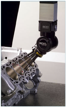

High-speed, infinite-position measurement has enabled new approaches to probing. For example, helical scanning can greatly speed the measurement of bores while generating thousands of data points to determine roundness, concentricity, or taper, as seen in the images at the left side of this page and above. A sweeping scanning routine can capture the edge geometry of a turbine blade by tracing back and forth from each side of the blade.

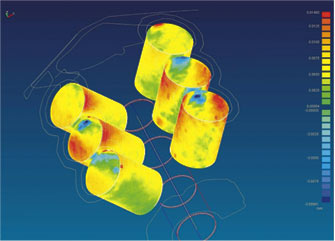

A leading automobile manufacturer has assessed the system’s massive data-capture capabilities to measure engines for wear analysis and cylinders for their deviation in spatial orientation. The captured data are compared against new-engine specifications; colors are assigned to the wear deviation to generate graphics similar to a thermal scan, as seen in the image below.

Dynamic measuring head. A two-axis, infinite-positioning head performs most of the measurement work. A 3-D measuring device in its own right, the head minimizes CMM motion and associated inertial errors, and its low-mass, low-inertia design allows ultra-high-speed data capture -- up to 4,000 points/sec compared to 200-300 data points/sec with conventional scanning.
Although the head provides the capability for simultaneous five-axis movement, its greatest advantage is that it can limit CMM motion -- where motion is required at all -- to what a CMM is designed to do best: move at constant velocity while measuring. Lighter and more dynamic than the CMM, with a significantly better frequency response, the measuring head can quickly follow changes in part geometry without introducing harmful dynamic errors caused by inertia when moving a CMM’s more massive linear axes. The dynamic head design also collapses measurement uncertainty to achieve high accuracy despite the phenomenal increase in speed. Measurement occurs within the head just a short distance from the point of part contact, rather than at distant CMM axis encoders. These encoders are separated from the point of contact by connected machine members and components, each contributing its own "noise."
Two rotary drives -- 360° in the horizontal plane, and 120° in the vertical plane -- provide wrist-like action for infinite adjustment to the part surface while measuring. The head features greater bandwidth than a conventional CMM, enabling accurate, high-speed following of the path demanded by the software. Proprietary technologies -- including hard-gold slip-ring contacts, high-resolution, 0.08 arc-second rotary encoders, and spherical air bearings -- minimize friction and wear, enable high-dynamic response, and provide a stiff metrology platform for reliable positioning accuracy at high speeds and acceleration forces.
The REVO head differs from indexing heads available as CMM options. Indexing heads provide adjustments at 2.5°, 5°, and 7.5° increments, but the heads must be unlocked, rotated into the desired position, and then locked again before measuring. This slows the measurement process and complicates programming and calibration. The infinite-positioning head measures without having to return to a zero position, thereby maintaining surface contact and precisely capturing fine changes in complex part geometry.
Five-axis control. Proprietary software drives the dynamic measuring head and synchronizes its motion with the linear moves of the CMM, providing five-axis continuous measurement. The head rotates and measures simultaneously to reduce delays in moving from part feature to part feature, thereby shortening cycle time. Look-ahead algorithms profile the probe path as a single continuous motion. The software features error-mapping routines that compensate for the effects of geometry, temperature, and machine dynamics.
Laser-measurement stylus. An innovative engineering solution provides a low-mass, low-inertia stylus that deals with the bending stresses of rapid direction changes, high acceleration, and inertia forces. Unique tip-sense probing features a hollow-tube stylus with an internal laser to measure controlled tip deflection. A laser beam is directed from its source in the probe body, down the hollow stylus to a reflector at the stylus tip. Bending deflects the return path of the laser beam, which is received by a position-sensing detector (PSD) in the probe body. Software algorithms combine PSD input with head geometry and CMM axis scale, calculating the stylus tip position in space. Laser light measures faster than the probe can move, so the position can be continuously determined while the stylus tip is scanning. The probe delivers 1 µ m accuracy at 250 mm from the axis of rotation at 500 mm/sec. Laser measurement enables longer styli -- up to 500 mm -- with little degradation in accuracy.
Tip-sensing probe heads require only a single tip location calibrated to be accurate at all angles of rotation, which typically saves several hours during a setup routine. Using a table-mounted sphere, the simple calibration technique determines the head and probe geometry, allowing measurement in any position after a single calibration. The system can save the equivalent of days of calibration time per month and ensure maximum availability of the CMM.
