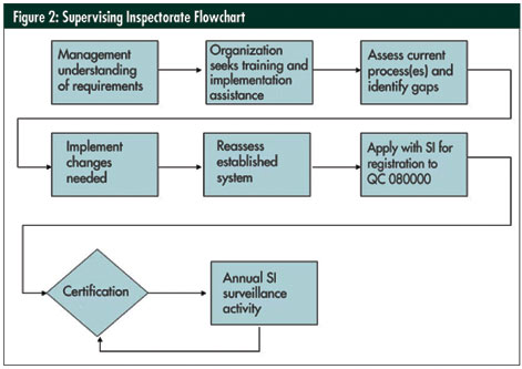

All of this adds up to the need for a process-based solution to manage existing global hazardous-substance restrictions. QC 080000 is that solution. The initial steps for an organization begin with senior management’s awareness of the applicable laws and how the QC 080000 specification can address these requirements. The steps to certification are outlined in figure 2, above, and must be executed by a supervising inspectorate (SI) authorized by the IECQ. For example, as the SI, a registrar such as NSAI would perform the assessments for ISO 9001 and QC 080000 simultaneously.
That said, not all registrars are approved SIs to the IECQ, so ISO 9001 and QC 080000 assessments can be done by separate third parties. Although there are obvious savings when these assessments are combined, this is the choice of the client. The IECQ has specific guidelines that outline the number of audit days allowed for the initial registration and surveillance. Much like ISO/IEC Guide 62, audit days are based on the number of employees in the organization. Audit days for the initial assessment range from one and one-half days for an organization with up to 50 employees, to up to seven assessment days for organizations with up to 4,000 employees. Once an organization has obtained certification, an annual surveillance assessment that ranges from one to five audit days is required to maintain compliance. Unlike with ISO 9001, organizations aren’t currently required to seek a three-year reassessment for QC 080000.
