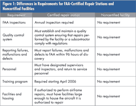

The FAA has responded to these findings, in part, by introducing a risk-based inspection program that identifies those repair stations doing the most work for airlines and monitoring their operations more closely. At present, it is estimated that the FAA has certified close to 4,600 domestic and 650 foreign repair stations. However, in addition to the FAA-certified repair stations, a growing number of noncertified repair stations are performing safety-critical work, according to a December 2005 report issued by the DOT IG. By definition, the work performed by these noncertified repair stations is not overseen by the FAA inspectors. Even though the work performed in such noncertified stations must be performed by FAA-certified mechanics and inspected by FAA-certified inspectors, there is a dramatic difference between the regulatory requirements for certified and noncertified stations, as seen in figure 1 below.
