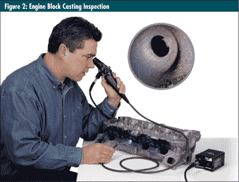

Control of the direction of view is the most important issue, after diameter, when choosing a flexible borescope. The simplest flexible borescopes have a gooseneck sheath that allows you to set the shape before insertion. More expensive flexible borescopes have articulated tips, allowing you to control the direction of the tip back and forth in a single plane (two-way) or in two perpendicular planes (four-way), using levers on the borescope body. You can use the articulation to steer the scope to its destination, then look around. Flexible borescopes allow the inspection of complex castings like engine blocks and turbochargers, tubes, pipes and turbine engines. The best flexible borescopes relay images through bundles of up to 25,000 optical glass fibers. The fibers are acid-leached to separate each fiber from its neighbors, reducing crosstalk between them and increasing contrast for whiter whites and blacker blacks. An impermeable plastic sheath prevents entry of fluids, such as fuel or oil. A tough, durable, woven tungsten wire sheath that reduces friction and protects the scope from damage by burrs and sharp edges surrounds and protects the plastic sheath.
Foundries that cast automotive engine blocks, turbochargers and exhaust manifolds find it very difficult to check for residual sand, blockages, flash or voids because the castings often have complex, inaccessible cavities and winding pathways. They use flexible borescopes that range in diameter from 0.100 in. (2.5 mm) up to 0.5 in. (12 mm). By controlling the articulated tip, they steer the borescope as it snakes through the part.
