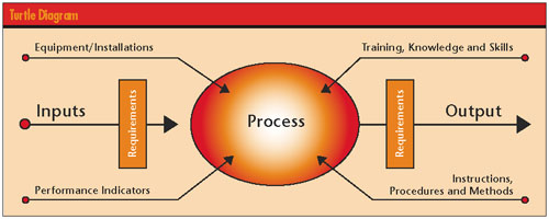

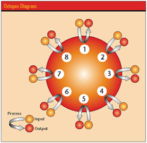

Along with these five basic tools, additional methods are now in use. ISO/TS 16949:2002’s new process approach emphasizes process auditing, and internal auditors are expected to identify turtle and octopus diagrams that lead to preventive action reports, as illustrated on pages 60 and 62. This approach should produce many more PARs than the traditional corrective action report method. If all process activities are correct and flawlessly executed, outputs will likewise be flawless.
