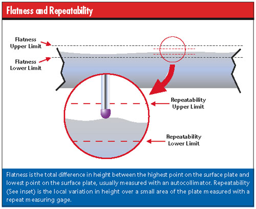

Flatness and repeatability are the two key specifications that define a surface plate’s accuracy. Federal specification GGG-P-463c lays out the specification for each grade of surface plate. Roughly, these two specifications can be defined as follows:
Flatness. This specification means that all points on the surface of the plate will lie between two parallel planes separated by the flatness tolerance. Put another way, if you look at the surface plate from the edge, the difference between the lowest point on the plate and the highest point on the plate will be no more than the flatness specification. Manufacturers use three standard grades of flatness defined by the federal specification:
  • Laboratory grade AA: (40 + diagonal [in inches] of surface plate squared/25) x 0.000001 in.
  • Inspection grade A: Laboratory Grade AA x 2
  • Tool room grade B: Laboratory Grade AA x 4
Depending on the manufacturer, this specification may be shown as total indicated reading or as a plus/minus tolerance. Both mean the same thing. A surface plate with a TIR of 250 uin. is no different from a surface plate with a flatness of +/- 125 uin.
Repeatability. The repeatability of surface plates is measured with a repeat measuring gage, sometimes called a Repeat-O-Meter, after the gage invented by Rudolf Rahn, a pioneer in granite surface plates (See the sidebar above). This instrument simulates placing a gage block and height gage on the surface plate. The gage is placed at the center of the surface plate and zeroed. As the repeat measuring meter is slid across the plate, the indicator will show any local deviation in the plate’s flatness. Repeatability measurements are taken across the entire surface to ensure that there are no local peaks or valleys that fall outside the repeatability specification. This specification is much tighter than that of flatness and also varies with the diagonal of the plate. For a plate with a diagonal of between 30 and 60 inches:
  • Laboratory grade AA: 45 uin.
  • Inspection grade A: 70 uin.
  • Tool room grade B: 120 uin.
For example, to fully meet federal specifications, a laboratory grade AA 48 x 60 in. surface plate would require an overall flatness of within 280 uin. but must not have a localized variation of more than 45 uin.--as measured by a repeat measuring meter.
