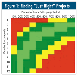

Find a Goldilocks project. Some projects are too small. Some are too big. Your goal should be to find a project that's "just right." Use the guide in figure 1, above, to help you find the sweet spot. The red spaces represent projects that are much too big or two small; yellow ones are a little too big or small; dark green is getting close; and light green is just right.
