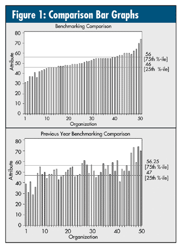

Suppose we have a baseline and post-baseline snapshot of some key characteristic--summarized in figure 1 (25th and 75th percentiles drawn in). The organizational ordering (i.e., x-axis) is identical on both graphs.

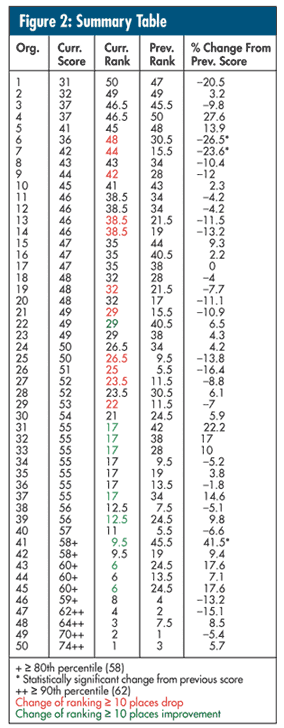

A typical comparison is summarized in the table in figure 2. The last column's "percent change from previous score" allows further (useless) comparison for a chosen performance standard rather than the alleged statistical significance: a difference in performance of, say, ± 10 percent or ± 15 percent, or perhaps plus or minus some arbitrary percentage ending in 0 or 5.
By the way, has anyone asked the question, "What constitutes a statistically significant difference from any declared benchmark?" Or, "What might constitute a criterion for declaring a benchmark?"
