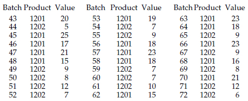

Unit 12 is used to make Products 1201 and 1202. The final characteristic for Product 1201 has a target value of 19.0, while the final characteristic for Product 1202 has a target value of 8.0. Batches 43 through 72 contain short runs of both products.
Figure 1: Data for Unit 12
