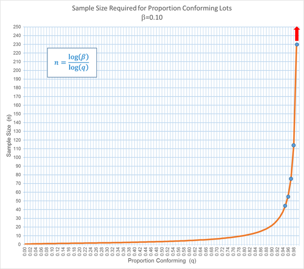

Aerospace standard AS9138—“Quality management systems statistical product acceptance requirements” was issued this year (2018), a few years after its accompanying guidance materials in section 3.7 of the International Aerospace Quality Group’s (IAQG) Supply Chain Management Handbook. The new aerospace standard supersedes the aerospace recommended practice of ARP9013 and, related to MIL-STD-105 (ANSI/ASQ Z1.4), claims to shift focus from the producer’s risk to the consumer’s risk with sampling plans having an acceptance number of zero (c=0).
Somewhere along this evolutionary path, the sampling procedures of MIL-STD-105 have fallen out of favor, even though the consumer risks of MIL-STD-105 at their designed lot tolerance percent defective (LTPD) point are superior to most plans found within AS9138.
