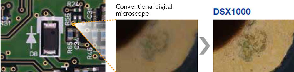

A second benefit is the combination of high magnification and high resolution.
With traditional compound microscopes, resolution decreases as the magnification increases. If you are inspecting an uneven sample, this makes it hard to see fine details and defeats the reason for using a higher magnification objective.
Paired with a high-resolution, long working-distance objective, the DSX1000 digital microscope captures clear, detailed images of your sample. In addition, the longer working distance minimizes the risk of crashing the lens into the sample. This extra room is helpful when working with uneven samples, such as molds and metal parts.
The DSX-1000 gives high-resolution images at high magnification.
When inspecting uneven samples, it is important to maintain a safe distance between the lens and sample to keep from damaging it. To see details, you need to increase the magnification, but this typically results in worse resolution. The DSX-1000 gives high-resolution images at high magnification.

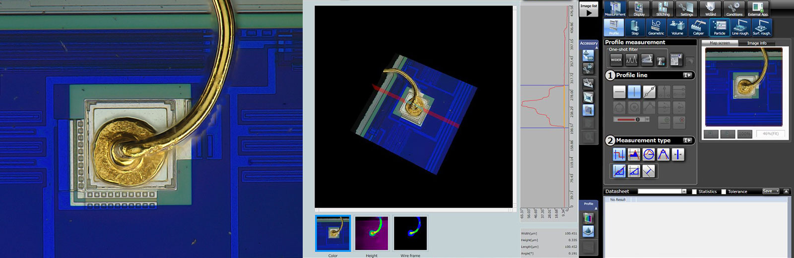

Measurement accuracy and repeatability
Another key feature is the microscope’s accuracy and calibration traceability to NIST standards.
A microscope with high magnification and high resolution is fine if all you need is a visual inspection. But in many cases, users need dimensional measurements as well. With traditional compound microscopes, measurement accuracy can be an issue at higher magnifications when looking at a tall object. A slight difference in the focus—by one user or between users—can make a significant difference in the apparent size of the feature. This inconsistency can affect where the user makes measurement points.
