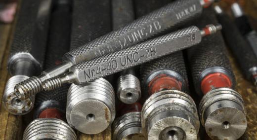

Part one laid out the procedure for data collection as well as the signal detection approach, which identifies and quantifies the zone around the specification limits where inspectors and gages will not obtain consistent results. The signal detection approach can also deliver a rough estimate of the gage’s repeatability or equipment variation. Go/no-go gages that can be purchased in specific dimensions, or set to specific dimensions (e.g., with gage blocks) do indeed have gage standard deviations even though they return pass/fail results.
