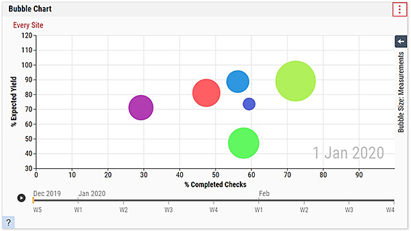

As an example, he points to the chart in figure 1, from Enact, which shows expected yield vs. on-time checks for several different sites. This “bubble” chart summarizes data from multiple control charts across a company so that compliance to limits as well as time are available at a glance. It enables appropriate decisions to be made at an organizational level. An additional benefit of this visualization is that these summary results can be animated through time to see how yield and on-time collections change.
Figure 1: Bubble chart showing expected yield vs. on-time checks for several different sites (bubble size represents the amount of data for that site). Clicking on an individual bubble reveals more details.

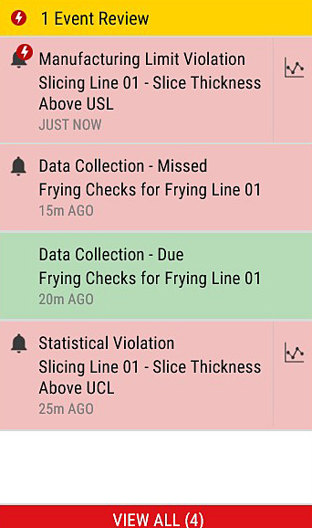

Similarly, figure 2 shows a collection of notifications that are relevant to the current user, including a specification limit violation, a statistical violation, and both a due and missed timed-data collection. This type of chart is nothing new, Weisbrod says, but it can be invaluable when used in a specific and strategic way: “Set up your rules in the system, and let the system tell you when to take action,” he says. These notifications are the starting point for further investigation. Additional actions such as adding comments, selecting assignable causes, taking images, and viewing relevant control charts can all be accessed from these notifications. “This can work at all levels of an organization but tends to be a site-focused solution,” he says. The goal is to reveal meaningful insights in the data, a focus that gets to the heart of quality intelligence.
Figure 2: Notifications provide users with quick access to relevant issues.

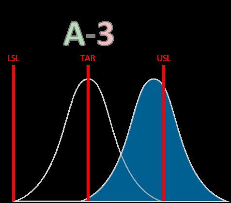

Figure 4: An “A3” grade is defined as being capable of achieving 100-percent yield (that’s the “A” part of the grade) but is performing at less than 90 percent of that potential (that’s the “3” part).

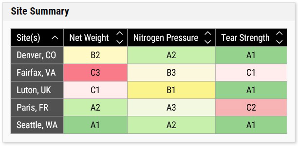

“This leads to organizations asking questions like, ‘What is the Cpk of my site?’” says Weisbrod “The spirit of this question is sound, but trying to determine this metric is fundamentally flawed.” Data stream grading was created so it could be rolled up; by making sense of all the data it collects, an organization can know where to effectively prioritize its resources (see figure 5). Employing yield-based metrics on critical characteristics is an effective way to roll up data across a site so sites can be meaningfully compared. Using simple A/B/C and 1/2/3 grades, emphasized with colors, allows users to directly drill in to the sites of interest.
Figure 5: A site‘s summary tiles for key characteristics allow a user to quickly identify areas of interest and prioritize resources to address issues and leverage opportunities.

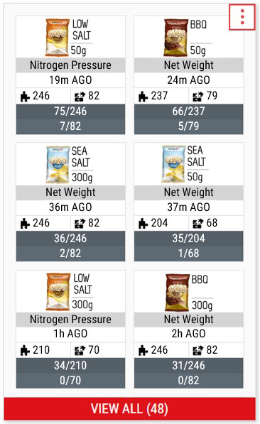

“Next-generation SPC is still SPC; it’s just dividing the workload to make humans more efficient,” says Weisbord. “Statistical rules should be configured properly for the part, process, or feature being charted. Once these are set, they should be responded to only when violated. Let the computers do the more mundane tasks like looking for those violations, and let the humans do tasks they are better suited to, like problem solving.” Figure 6 shows a data-stream summary tile where each image represents a control chart analysis, and all data streams are sorted based on the violations in the data stream. The operator’s goal is to have an empty tile, meaning none of their processes have violations.
Figure 6: Stream summary tiles represent a control chart analysis. The data streams are sorted based on how many violations exist in that data stream.

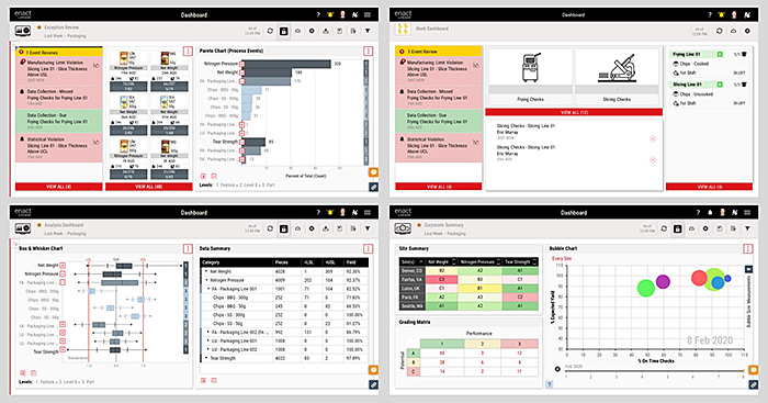

Just like the other quality tools we’re all used to, no quality intelligence tool stands completely alone. It is when the right tools are combined that we are able to extract the most information. Figure 7 shows several dashboards using different tools to display data relevant to different users.
Figure 7: Dashboards can be configured to display relevant information to users at all levels of an organization.
