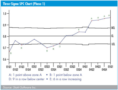

The figure above shows a standard three-sigma SPC chart for the fictitious Sutter St. Elsewhere Hospital, revealing the performance over time in getting ACE inhibitors to CHF patients as they are discharged from the hospital. Although the data are fictitious, they reflect real progress at Sutter Health in getting this important medication to people who have been hospitalized with CHF.
Because numerator and denominator data are available for this measure, a p-chart is used. Statistical process control software plots the individual data points, draws the center line as the average of the data points and draws the three-sigma control lines. The width of the control lines varies from quarter to quarter because the sigma measure depends (in part) on sample size, which in this case varies over time. Most important, the SPC software looks for and labels "rule violations," that is, cases where a particular data point shows unusual variability given the history of the process. In the figure, the last four data points are labeled "A," meaning that they are beyond three sigma on the high side. Several earlier data points are labeled "B," meaning that they are beyond three sigma on the low side.

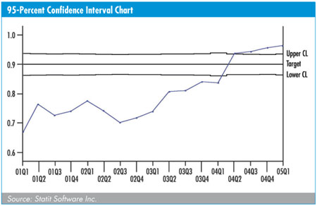

This figure shows significant improvement. Seeing this, one might ask, "How much improvement is enough?" All of Sutter Health's clinical initiative measures have targets attached to them, so one answer to this question could be, "When everyone is at target." Statistical process control by itself cannot provide the answer, so Sutter turned to another technique, developed by Dr. James, which involves "tricking" SPC software into drawing a pseudo-confidence interval chart.
To implement this technique, Sutter fixes the center line at the target (i.e., 90 percent in the case of ACE inhibitors at discharge), rather than letting the software calculate the center line. In addition, the software draws two-sigma limits, rather than the standard three-sigma limits. Finally, the rule violation labels are turned off because they have no meaning in this context. The result, as shown in the figure above, is an unusual-looking but useful 95-percent confidence interval chart (three-sigma limits would produce a 99-percent CI chart).
Interpreting the data is simple: If a data point lies outside the 95-percent "envelope," it is significantly different from (i.e., higher or lower than) the target. Points inside the envelope do not differ, in a statistical sense, from the target.
In the present (fictitious) case, we see that although Sutter St. Elsewhere made significant positive progress from an SPC perspective, it took the hospital more than three years to move its ACE performance into (and beyond) the target zone.

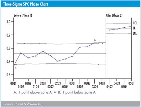

Control
In an industrial Six Sigma effort, control could mean keeping a process within a tight set of specification limits. This is less relevant in a health care setting--at least in the early stages of clinical improvement--where, in most instances, we want to see a process demonstrate significant upward movement. In other words, we want our processes to be out of control. However, as time goes on and clinical improvement processes start to mature, we hope to be in a position to utilize another tool in the SPC arsenal: the phase chart. This chart splits a process into "before" and "after" phases. It's commonly used in industry when a major change occurs--when a robot car painter replaces a human one, for example. Changes in health care delivery are not usually that abrupt, but the goal is to have most processes working at a relatively high level with relatively low variability.
For illustrative purposes, we will suggest that the ACE inhibitor process at Sutter St. Elsewhere moved to a steady-state phase 2 between the first and second quarters of 2004. The figure below presents the appropriate SPC chart for this process.
The phase chart shows a process with significant improvement over 12 quarters, followed by four quarters where the process is in control at a new, higher level.
At the moment, it is rare that a health- care delivery process shows this kind of abrupt shift and steady-state maturity. Sutter Health is committed to using Six Sigma tools for the long term, however, and looks forward to getting all of its quality processes in good control.
