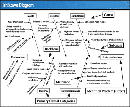

Was Dr. Tahl correct? Are cause-and-effect diagrams used for the same purposes as Pareto charts in this or any other case?
No. A cause-and-effect diagram shows various system elements that might contribute to a problem or outcome. It’s used to uncover root causes. Pareto diagrams sort data by frequency of occurrence but don’t identify causal relationships.
The cause-and-effect diagram was developed in 1943 by Kaoru Ishikawa, president of the Musashi Institute of Technology in Tokyo. It’s sometimes called an Ishikawa or a fishbone diagram because of its resemblance to a fish’s skeleton. Its graphic nature allows groups to organize large amounts of information about a problem and pinpoint possible causes. It also encourages investigation of causes at many levels, improving the odds that root or basic causes will be identified.
In health care settings, the cause-and-effect diagram can identify the variables influencing processes such as delivery, billing, purchasing or scheduling, as well as general problems such as absenteeism, turnover or wait time.
The cause-and-effect diagram is used to find and analyze causes of variation. It also can help solve problems that occur in a system. Although the diagram looks simple to make, it’s not easy to do well. Hitoshi Kume, a Japanese quality professional, noted, “It may safely be said that those who succeed in problem solving in quality control are those who succeed in making a useful cause-and-effect diagram.”
