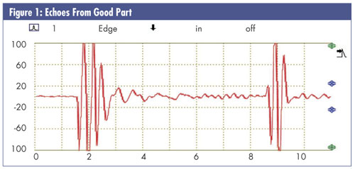

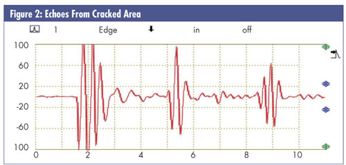

Ultrasonic flaw detectors also examine reflected sound waves, looking for distinctive echoes that reflect from cracks, voids, disbonds or other discontinuities in a test piece. High-frequency sound waves will travel through solid, homogeneous materials such as a steel beam or a uniform weld in a predictable pattern, and that pattern will be disrupted by a crack or similar discontinuity. A flaw detector displays these echo patterns on a screen. By comparing the echo pattern from a reference part with the echo pattern from a test piece and looking for differences in echo amplitude or position, a trained operator can identify hidden flaws before they become a problem.

Figures 1 and 2 below illustrate a typical test involving a steel plate with a small hidden internal crack. Figure 1 shows the reflected echo pattern from an uncracked part of the plate, with the two large peaks representing the echoes from the front and back surface. In this case, the operator establishes that this is the pattern representing undamaged material and that any changes in that pattern indicate a change in the test piece's condition. Figure 2 shows the different pattern from a cracked area, with a third peak appearing between the other two. The presence of a significant reflector between the front and back surfaces of the plate indicates a discontinuity, in this case a laminar crack.
