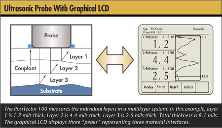

Ultrasonic testing measurement works by sending an ultrasonic vibration into a coating using a probe (i.e., a transducer) with the assistance of a couplant applied to the surface. This vibration travels through the coating until it encounters a material with different mechanical properties--typically the substrate but perhaps a different coating layer. The vibration is partially reflected at this interface and propagates back to the transducer. Meanwhile, a portion of the transmitted vibration continues to travel beyond that interface and experiences further reflections at any material interfaces (see left side of figure below).
Because a large number of echoes could occur, the gage is designed to choose the maximum or “loudest” echo from which to calculate a thickness measurement. Instruments that measure individual layers in a multilayer application also choose the loudest echoes. The user simply selects the number of layers to measure--say, three--and the gage measures the three loudest echoes. Softer echoes from coating imperfections and substrate layers are ignored.

Applied in single or multiple layers, the base coat provides most of the color, physical performance and aesthetic effect. However, distinguishing between these layers can pose a challenge for ultrasonic gages, depending on the application method. Resistant clear coats form the protective interface from environmental factors such as etching, bird droppings, car wash scratches and stone chips.

If more detailed information about this coating/substrate interface region is desired, ultrasonic instruments with a graphical LCD illustrate substrate roughness by displaying wide peaks when the substrate is rough and narrow peaks when it’s smooth, as shown in the figure below.
This type of display is useful when measuring coating systems where the number of layers is unknown. In the hands of a skilled operator, the gage presents interface information about bond strength and material densities.
