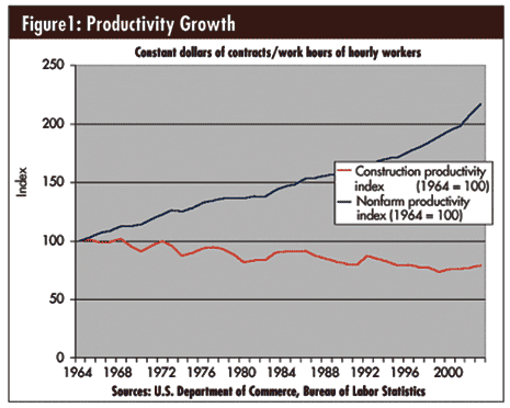

Construction is possibly the last frontier for lean. Although manufacturing’s productivity has improved during the last 40 years, the construction industry has experienced a slight decline, as seen in figure 1 below. Even though the construction world has embraced high-tech tools, we still manage projects the same way we always have, and we’re still getting the same poor results. Less than 30 percent of projects come in on time, on budget, and within specification. The answers to improving construction productivity are not in more software or technology.

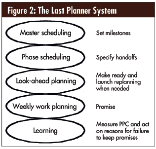

The Last Planner System
The Lean Construction Institute has developed a tool specifically for applying lean to project management. It is called the Last Planner System. The “last planner” in construction is the field supervisor who assigns work to the crews. In “The Theory of Project Management: Explanation of Novel Methods,” a paper written and presented by Lauri Koskela and Greg Howell at the proceedings of the International Group for Lean Construction held in Gramado, Brazil, on August 10, 2002, the LPS was described as outperforming traditional project management methods by:
Reducing variability common in construction so that work flows from one completed task to another
Completing a look-ahead plan—i.e., making work ready to be performed so that crews can finish a task without interruption, rework, or remobilization
Performing the weekly work plan—i.e., holding weekly coordinating meetings where last planners (supervisors) make commitments to each other in support of the schedule
Managing the project by monitoring the plan’s completion rate rather than the progress compared to schedule (effort). This creates a learning process by investigating plan failures.
The LPS consists of developing and using several key plans along with a weekly meeting and constraints measurement.
The master schedule is common to all major construction projects. The LPS breaks the master schedule into phased schedules. The team of trades and management, which is responsible for the work of that phase, develop each phase schedule. The master schedule shows how the phases of the project come together and when. The master schedule does not show the way work will be done within each phase; this is the role of a phase schedule. The phase schedule identifies the major activities and the rules for release of work to move from one activity to the next. The phase schedule sets the sequence and timing of activities in finer detail than the master schedule.
Activities developed in the phase schedule drop into the look-ahead plan when they are six weeks from happening. In look-ahead planning, these activities are magnified into greater detail (i.e., tasks). Each task is screened using a checklist to ensure that all requirements are made ready so that the task can be performed. A typical look-ahead plan focuses on when the activity is to be done and leaves the make-ready work to each supervisor.
The last planner, usually the foreman, develops a weekly work plan by selecting from the look-ahead plan those tasks that are ready to be done and are critical in the schedule. The key is to plan only work that is ready, regardless of when it should be performed. This is like pulling the cord on Toyota’s assembly line. In essence, the foreman says, “Stop, we will not do the work that is not ready to be done.” Typically, construction work is driven by schedule, not task readiness; project managers drive the subcontractors to start work that isn’t ready. This usually causes the crew to spend additional time returning later to finish the task. This wastes time and resources. The weekly work plan is the foreman’s commitment plan, and because it’s made up of tasks ready to be done and committed to by the foreman, it has a much higher likelihood of being completed within that week.
After each week’s work, the last planner identifies any constraints that kept him or her from doing the work as planned. These constraints are analyzed in a weekly coordination meeting, and action is taken to prevent future occurrences. Part of this weekly learning cycle is measuring the percentage of work completed.
Phased planning takes place several times, depending on the complexity of the building project. The look-ahead and weekly work plan, as well as the constraints analysis, are done weekly and represent current best knowledge of the job’s progress. The LPS provides the necessary tools for planning and controlling projects. In LPS, planning is what needs to be done and how it will be done; control is about making it happen. The LPS helps shield the crews from the variability common to construction and keeps them focused on installation. See figure 2 at right for an overview of the LPS.
