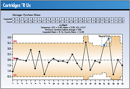

Answer B is correct. U-charts are attributes charts, but that’s the only part that Pyncheon Shooz had right. The statistical basis for u-charts is related to Poisson, rather than normal, distribution. A u-chart is a control chart for a particular type of attributes datum. The role of any control chart is to monitor how a system changes over time. Attributes data plotted on a u-chart typically monitor the number of nonconformities produced. The number of errors on invoices, the number of scratches or blemishes found on a car window or the number of areas left incomplete on application forms could all be plotted on u-charts.
These types of attributes data have no maximum number of potential nonconformities. The data aren’t constrained by the sample size, unlike other types of attributes data. Unlike the c-chart, the u-chart can deal with varying sample sizes. A u-chart with a variable sample size is offered on page 20. You might note that when the sample size varies by more than 25 percent, the control limits are adjusted appropriately.
