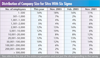

Although small businesses have shown some interest in implementing Six Sigma, it remains a program primarily used by the “Big Boys”--companies with more than 500 employees. However, we’ve recently seen several programs like the one initiated by Mikel Harry that offers Six Sigma online training through the Ira A. Fulton School of Engineering at Arizona State University. Such initiatives are helping small businesses implement Six Sigma. For most of these efforts, the challenge has been to change the program’s deployment model from one that works for large, well-funded corporations to one that adapts to the limited resources of small businesses.
According to our survey, this effort hasn’t paid off yet. This year, only 16 percent of respondents with a Six Sigma program in place came from companies with fewer than 500 employees. (See table below.) About two-thirds of those companies are part of larger organizations and most likely don’t bear the cost of training and implementation on their own--a notorious issue with Six Sigma for small businesses.

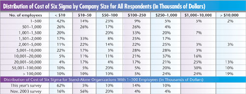

In an effort to map perceptions of the cost factor for implementing Six Sigma, we made the following statement in the survey: “Six Sigma costs a lot of money to deploy.” Predictably, those who have a program in place had a much different perception of this than those who don’t. For those respondents who don’t have a Six Sigma program in place and who had an opinion on the statement, 62 percent agreed, with 23 percent strongly agreeing. About 38 percent disagreed. For those who do have a Six Sigma program in place, the numbers were reversed, with 60 percent disagreeing with the statement (11% percent strongly disagreed) and 28 percent agreeing.
The table below shows the breakdown of Six Sigma costs by company size and whether the company is a stand-alone or part of a larger organization. In either case, the majority of respondents with fewer than 500 employees indicate that the total cost of Six Sigma implementation each year is less than $10,000. In the November 2003 survey, the majority of stand-alone companies with fewer than 500 employees reported yearly Six Sigma costs in the $10,000 to $50,000 range. The drop in cost could be due to a difference in how the data were collected or could mean that Six Sigma is becoming less expensive to implement for the small- to medium-size enterprise.
That Six Sigma implementation could cost less than $10,000 per year indicates that these companies probably don’t have full-time Six Sigma employees, the traditional recommendation for implementing the program. Mikel Harry, Thomas Pyzdek and other Six Sigma consultants have previously suggested that the big business approach to Six Sigma could be adapted to small business with Six Sigma-trained personnel using Six Sigma tools as a part of their normal job functions. This, perhaps, is what we’re seeing in smaller organizations.

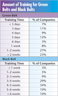

Training is a key element for successfully implementing Six Sigma. Nearly 22 percent of respondents with Six Sigma programs report that all employees are required to take Six Sigma training.
The amount of training time is also important. The table below shows how much time companies invest in Green and Black Belt training. For Green Belt training, the majority (58%) of companies require a week or more of training, with about 23 percent requiring more than two weeks. Black Belts require three times that amount of training. The majority (63%) of companies require three to five weeks of Black Belt training, and 20 percent require more than five weeks.

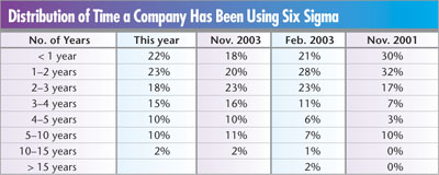

Three-year attrition rate
2004 shows a continuation of the trend for companies to abandon Six Sigma at about year three or four. (See table below.) There are several reasons for this. The most likely is that Six Sigma, in practice, is really no different than other quality programs. If it shows tangible results, companies continue to use it until they reap the immediate benefits. At that point, the major cost savings due to reduced waste have been realized. If Six Sigma efforts haven’t been expanded to include the product-design function, then companies most likely will abandon the program.
A comment that recurs every time we run this survey is that Six Sigma reaps benefits not so much because of its methodology but because it’s new, exciting and gets everyone to at least temporarily focus on their companies’ processes--always a good thing.
Mikel Harry suggested another scenario in an interview last year: Six Sigma has become “institutionalized,” i.e., it’s simply the way companies do business, even if those organizations don’t refer to the process as “Six Sigma.” Comments on the survey lend some support to Harry’s argument. Many companies still call their programs “TQM” and argue that it’s no different than Six Sigma.
A factor contributing to attrition could be loss of management support. Six Sigma gurus have always stressed that unless Six Sigma becomes a part of a company’s culture, the program will falter. The implication is that managers come and go, but the company lives on. If Six Sigma--or TQM, or Quality One, or We Be Quality--is a manager’s pet project rather than a culture-driven initiative, it will last only as long as the manager or the manager’s attention span. At that point, it’s on to the next big thing--or nothing at all.

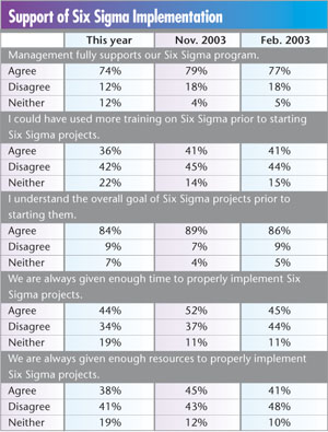

Those comments aside, most respondents feel the program is well-supported at their companies. About three-quarters (74%) of respondents agreed with the statement, “Management fully supports our Six Sigma program,” with 33 percent agreeing strongly. (See table below.)
However, when it comes to training, time and resources, the story strays somewhat from this rosy picture. About 36 percent of respondents indicated that they could have used more training prior to starting Six Sigma projects, with 42 percent indicating that training wasn’t a problem. Nearly one-third of respondents indicated that they weren’t given enough time to properly implement Six Sigma projects, with 44 percent indicating that time wasn’t an issue. About 41 percent of respondents indicated that they weren’t given the resources necessary to properly implement Six Sigma projects, and about 38 percent indicated that this wasn’t a problem.
