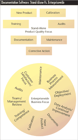

Enterprisewide software allows an entire system to be installed in one place and on one server. Whether it's used for audit administration, document management or process analysis and improvement, the software can support one site or 100--it isn't constrained by a LAN or site-specific requirements. Enterprisewide software isn't about duplicating the functions of one site at 100 others but rather addressing the complexities of how information, resources and data can be shared between sites and managed either centrally or at various "nodes" within the organization.
What's the difference between documentation software designed for one site vs. an entire enterprise? Site documentation takes into account the documentation structure of that site alone--a specific quality manual, procedures, work instructions and forms and checklists. Even if the software has been flexibly designed for multiple levels, it doesn't address the entire organization's needs. How does enterprisewide software handle this? Typically, one quality manual is shared by all sites, even though two procedural levels exist--common and site-specific.
Enterprisewide software provides the flexibility to design documentation at, say, site No. 100 that incorporates separate documentation from all or none of the other 99 sites. It provides standardized document control and consistent naming and/or numbering conventions for documents and records throughout the organization. It allows site No. 100 the flexibility of maintaining its own levels of documents. This includes the ability to establish a naming convention for its levels, borrow all or none of the documentation from other levels and create documentation.
In contrast, site-specific documentation software must be individually installed at each of the 100 sites. At most, the site packages can talk to each other if they're based on Lotus Notes or other groupware, and allow users to update specific common documents. More often than not, such software is mutually dependent and requires workstation application software to support it, whereas enterprisewide software is accessible through a Web browser already available at most workstations.

Focus on the company rather than product quality
An organization's business success dictates that its enterprisewide software focus on more than product quality and quality management systems documentation. Packages that focus primarily on these are easy to spot. One popular enterprise vendor's modules offer the following: documents, training, control plans and/or FMEAs, maintenance, calibration, inspection data, supplier management and auditing.
Another vendor provides these modules: documents, audits, corrective action and quality records, including training, calibration, customer complaints, engineering change and design review. Any package that doesn't address customer needs and expectations, organizational objectives, objectives deployment, performance measurement, customer satisfaction, continuous improvement and business processes--and neither of these packages do--isn't focused on the business.

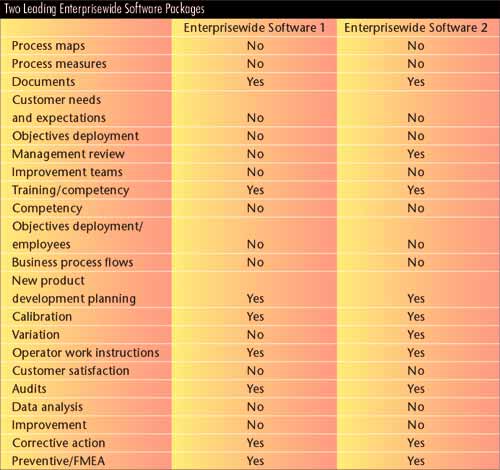

One way to judge a software's business focus is to see if it covers, at a minimum, ISO 9001:2000 functionality. (See the table below.)
From this matrix, it's clear that two leading enterprisewide software packages don't have a business or ISO 9001:2000 focus. That's because many packages were designed for ISO 9001:1994 and its now-outdated element structure and product-quality focus (i.e., inspection and product measurement).
