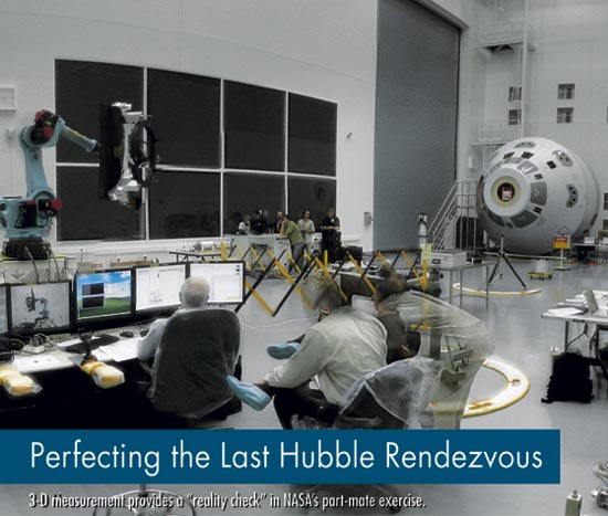

Aligning and mating two moving objects in space is no small task. NASA engineers have proposed a theoretical vehicle-alignment and part-mating methodology designed to systematically connect the Hubble with another spacecraft. To prove out the concept, a team of experts recently gathered at NASA Goddard for a trial run of its groundwork in sensor technology.

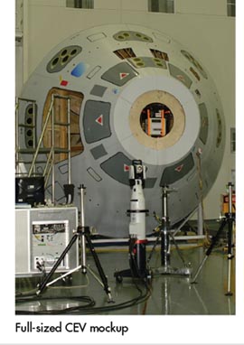

The test was made up of five key components: robot, soft-capture mechanism (also called an “attachment fixture”), crew-exploration vehicle (CEV), space-certified sensor technology, and a laser tracker with a wireless probe. At one end of a clean room, the attachment fixture was mounted onto a FANUC robot, which moved the fixture in a floating space- replicating motion. At the opposite end of the clean room was a full-sized CEV mockup positioned on its side (as seen in the image on page 21). Just inside the vehicle’s opening were three different sensor systems used to locate the fixture and provide positioning data to align the CEV with the Hubble’s attachment fixture. Finally, to the left of the CEV was a Leica laser tracking system used to verify that what the navigation sensors seemed to be detecting was really what was happening.
Bo Naasz, NASA aerospace engineer at the flight dynamics analysis branch, led the weeklong endeavor. Naasz and other team members worked several long days in the simulation environment. Representatives from NASA, FANUC Robotics America Inc., Leica Geosystems, Neptec Design Group, Ball Aerospace & Technologies Corp., and Advanced Optical Systems Inc. offered their expertise for the duration of the exercise.
“The testing being done is laser imaging of the soft-capture mechanism, which will be installed on the Hubble during Servicing Mission 4,” says Naasz. “The soft-capture mechanism has retroreflectors and a LIDS [low-impact docking system] adapter on it. The objective of our work is to make the next rendezvous with the Hubble easier. In the past, our Hubble encounters were made with the Space Shuttle, and Servicing Mission 4 may be the last time we go back to the telescope with the Shuttle. We believe a final rendezvous with the Hubble will occur as NASA safety requirements necessitate that we park it somewhere in the South Pacific Ocean.
“In anticipation of this event, this week of testing was all about demonstrating our ability to estimate relative position and relative orientation of our suite of sensors to the soft-capture mechanism.”
To conduct the test, the team mounted the soft-capture mockup onto a FANUC robot, which provided limited six-degrees-of-freedom (6DOF) motion to move the target around, simulating the movement conditions that a docking craft might encounter when approaching the Hubble. As it was being moved around, the mockup was imaged with three different engineering prototype relative navigation sensors that will be mounted to the docking craft to help guide it into position with the Hubble. A Leica LTD840 laser tracker was used to provide “truth information” for the relative positioning and orientation, comparing the data from the sensors to the actual data collected by the laser tracker to determine how well the sensors performed.
“We are trying to gain as much expertise as we can with these technologies and the target we will ultimately use for the last Hubble rendezvous,” explains Naasz.
The three sensing technologies being evaluated offer unique approaches to pose-and-position measurements, rendezvous and docking issues, and orbital proximity operations. Neptec’s TriDAR integrates a dual-sensor 3-D scanner and a full-pose (6DOF) docking sensor. Ball Aerospace demonstrated the capabilities of its 3-D flash-imaging laser detection and ranging (LIDAR) system providing real-time target topography. Advanced Optical Systems presented its Advanced Video Guidance Sensor, which uses laser light to illuminate retroreflective targets and then uses the return light to compute 6DOF information.
Requirements for measurement validation and data redundancy were also factored into the test program with the use of the high-precision Leica laser tracking system. The portable coordinate measuring machine provides a measuring rate of up to 3,000 points per second, with a measurement range of up to 40 meters (131 feet). Based on a high-speed tracking 3-D laser interferometer and precision angular encoders, the laser tracker enables scientists and manufacturers to capture 3-D coordinate data on demand, perform alignments and part mating, confirm close tolerance work, conduct complex assemblies, and more.
The reality check
The laser tracker works in tandem with a Leica T-Probe, a wireless 6DOF tracking device for automated applications. The wireless probe has a point rate output of 1,000 points per second, a measurement volume of up to 30 meters (98 feet), and an ultra-wide acceptance angle: pitch ±45°, yaw ±45°, roll 360°. The probe has a single retroreflector so that the laser tracker can track its position, and the 10 LEDs on its surface are registered by the tracker’s camera to track its orientation in space. Insensitive to environmental light, the device delivers a two-sigma length measurement accuracy of 60 µm in a measurement volume of 15 meters (49 feet).
The T-Probe was mounted securely to the soft-capture mechanism and was used to measure dynamic 3-D motion data (x,y,z, pitch, roll, and yaw) as the robot moved the attachment fixture randomly in space. During the test cycles, precision data was captured by the device to be used later to validate measurements simultaneously gathered by each of the three sensor systems.
Presiding over the laser tracker operations was Brent Barbee of Emergent Space Technologies Inc., headquartered in Greenbelt, Maryland. Barbee used two software programs-- SpatialAnalyzer (New River Kinematics, headquartered in Williamsburg, Virginia) and a specialized software program developed for the laser tracker at NASA’s Marshall Space Flight Center--to interface with the tracker and give continuous time-stamped measurements of the T-Probe’s orientation in space.
Once the testing is concluded, the arduous task of post-processing the data gathered from the test cycles must be tackled. Barbee has written a script to translate the Leica “truth data” into the coordinate frame of the sensors being evaluated. Essentially, they have all the information that they need to compare apples to apples, comparing motion data reported by the three sensor sources under evaluation to the data acquired by the laser tracker.
As of this writing the data analysis is still ongoing. The results of the analysis will help NASA determine which of the three sensor technologies will be used to help dock to the Hubble.
