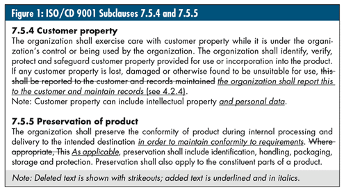

For ISO 9001, the committee draft includes changes in about 30 areas. Some are simply needed updates to references or other editorial changes. The others, in my opinion, are all clarifications, and none are intended to change the requirements. The examples shown in figure 1 illustrate the type of changes that are proposed in the committee draft.
In both cases, the proposed text reads much better. Of course, there are more drafts ahead, and wording may change. If the current direction is sustained, the 2009 version of ISO 9001 should be almost identical in requirements to the current version but should be more easily understood.
