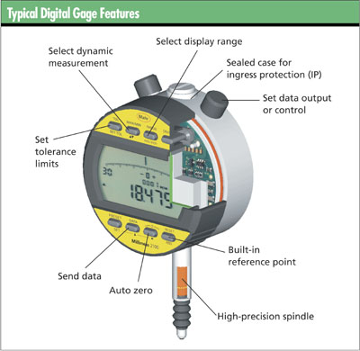

Digital indicators’ clearest advantage is for data collection in process control. Digital devices can output measurements directly to printers or statistical process control programs with no operator errors in reading or recording. The operator has only to position the workpiece and press a button or foot pedal; reading the measurement isn’t necessary. With dial indicators, the operator must interpret the pointer’s position to read the measurement, then record it, usually by hand. Finally, the data must be keyed into a computer. That makes three steps during which errors can--and frequently do--occur.
A related problem, common among users of dial indicators, is failing to notice whether the pointer has made one or more full revolutions. Parts that are grossly out of tolerance might appear to be within tolerance to an inattentive operator. In contrast, digital indicators never come “back to zero,” eliminating this problem entirely. Furthermore, all digital indicators can be made to signal out-of-tolerance dimensions.
Dynamic measurement
The latest digital indicators can take and hold certain types of readings even while the workpiece is being manipulated. These dynamic measurement capabilities include “min,” “max” and “TIR” (total indicated reading) and give digital gages many of the functions usually found in electronic amplifiers, which include bench amplifiers, column gages and digital amplifiers.
The min and max features enable an operator to capture the gage’s smallest or largest measurement of a dimension without having to watch as the readout flickers up or down. This eliminates one of the liabilities of earlier digital indicators: the impossibility of taking a reading, even an approximate one, until the workpiece and the gage were both absolutely stationary.
Rocking-type bore gages are a popular application for the min feature. The operator inserts the gage into the bore, pushes a button to select the min function and rocks the gage. The indicator remembers the measurement and displays only the smallest dimension detected--i.e., the true diameter. It ignores any larger dimensions, such as those indicated when the gage isn’t perpendicular to the bore.
The max feature can be equally useful. For example, when measuring outside diameters on a bench comparator, the operator rolls a part under the contact and the indicator reads the largest dimension detected. The operator needn’t even look at the readout while handling the workpiece because the reading remains on the display until the indicator is reset.
Min and max features are even more effective when used in conjunction with data collection systems. If a tolerance is unilateral--i.e., only the maximum or the minimum reading is critical--then the operator can transfer the reading even under dynamic conditions. It’s no longer necessary to hold the gage steady while simultaneously attempting to press the “send output” button.
The TIR feature is used most often in measuring the runout of shafts, so it’s sometimes called “total indicated runout.” But TIR can also be used to check thickness variation in flat parts and other differential applications. For example, a shaft is put on a gage and rotated through 360 degrees or more. The indicator notes both the min and the max readings but displays neither one. Rather, it remembers both readings, then calculates and displays the spread between them. (For example, if the min is -0.001 in. and the max is +0.003 in., then the TIR is 0.004 in.) The reading doesn’t change, even if the operator continues to rotate the shaft, because min and max remain the same.
Another related feature is “hold/reset.” This is used primarily where the readout is difficult to observe: for example, where the entire gage is inserted into a part to measure an awkwardly placed internal dimension. The hold feature allows the indicator to retain the reading so that the operator can extract the gage and view the readout, then clear it with the reset button.

Advanced usability
Today’s feature-packed indicators al-so allow users to choose the best resolution for their gaging requirements. One common application error is caused by having too many digits visible on the display. Flickering digits make the gage look unstable and can confuse the operator. Keep in mind that more digits don’t mean better measurements. Turning off the extra digit stops the flicker and simplifies reading. Matching resolution to the gage performance just makes the user’s job easier.
A number of features included in newer gages are designed to take guesswork away from the operator. These include:
Preset features. These place the actual part size on the display so the operator can match the print to the indicator.
Tolerances. By allowing the display to classify the part, operator influence can be reduced. Tolerance can be set as balanced or unilateral (i.e., on both sides or one side). Thus, with an indicating symbol, the operator can easily see whether the part is good or bad. Many digital indicators also incorporate colored displays--i.e., green when the part is good, red when it’s out of spec.
It’s important to lock out these changeable features. Nothing is worse than nimble fingers sneaking in and changing these flexible features in process. Through passwords, special programming keys or remote setup by computer, these features can be locked out. This makes the digital indicator almost like an analog one: purpose-built or set up for an application, although in this case, the electronics can be changed later. The operator sees what he or she needs to but isn’t tempted to make changes.
Finally, some indicators come with multiplication factors. Often used with three-point gaging, levers and such, these indicators have selectable multiplication factors built in for these applications.

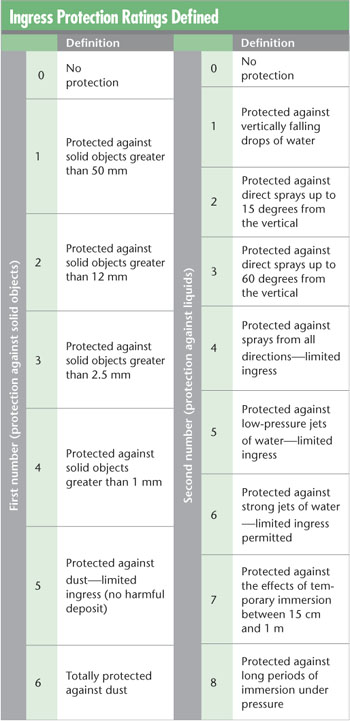

Ingress protection ratings
Digital electronic gages have become increasingly common on the shop floor because of their ease of use, speed and ability to take complex measurements. However, when it came to caring for early digital gages, you didn’t want to get one anywhere near water or coolant, or there was sure to be trouble. Either the gage wouldn’t work, or--even worse--it would produce incorrect readings.
Major improvements to many electronic gages have finally given these tools the characteristics needed to survive on the shop floor. Advances in scale technology, microcircuits and sealing even allow gages to make measurements under water.
A new standard has been set up to help identify what type of tool is best for the environment in which it will be used. This rating is called ingress protection (IP). Associated with the IP is a two-digit rating number that tells what type of conditions the gage can survive in. The first digit describes the protection factor for solid foreign objects, while the second digit indicates protection against harmful ingress of water. A third digit, which is the defined impact protection, hasn’t yet made its way into the measuring instrument table, which is detailed in the figure on the following page.
For example, a gage with a rating of IP-65 is totally protected against dust and low-pressure jets of water from all directions, with limited ingress permitted. Today there are calipers and micrometers with ratings as high as IP-67. These can be subjected to the type of dust and dirt found in the shop and are both water- and coolant-proof.
However, just because a gage can handle the environment doesn’t mean the measurements taken with it are impervious to environmental conditions. These are still precision gages, and all the basic rules for precision gaging still apply.
