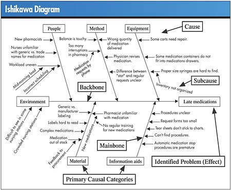

a) Amazingly, he’s managed to identify the Ishikawa diagram without ever seeing one.
b) Sorry, Simsack. The only thing Taguchi and Ishikawa have in common is that they’re both named after Japanese statisticians.
The correct answer is b. Simsack is wrong again.
Taguchi is known for his work on the loss function that first gained recognition during the 1980s. The Ishikawa diagram is more commonly referred to as a “fishbone” or cause-and-effect diagram. It was developed in 1943 by Professor Kaoru Ishikawa, president of the Musachi Institute of Technology in Tokyo.
The Ishikawa diagram is an excellent tool to apply to problem solving. For example, in the chart above, the problem for a hospital pharmacy is identified as “late medications.” Brainstorming has elicited possible causes for this problem, recorded on appropriate “bones” or categories. The next step involves looking for the most likely cause(s), and then collecting data about the current situation with respect to that cause.
