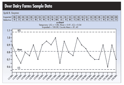

Like p-charts, u-charts record attributes data. But the distinction lies in the difference between go/no-go situations, in which a product either has a defect or it doesn’t, and nonconforming products, which might have several defects in a single product. The p-charts show data relating to the proportion of rejected containers, whereas u-charts give information about how many individual defects are recorded in samples.
For example, manufactured parts that are the wrong dimension and tested with a go/no-go approach should be charted on a p-chart. Ice cream, on the other hand, might have too many chocolate chips, a sloppy label and insufficient fill--all in the same container. Instead of recording the ice cream container as good or bad, more useful information would be gathered by identifying the kinds and number of defects in each batch of containers. This could be charted with a u-chart and future analysis done by means of Pareto charts.
An example of a u-chart is illustrated here.
