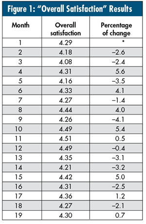

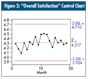

Figure 1 shows one clinic’s “overall satisfaction” results for 19 months, and figure 2 shows the resulting control chart, which the outside firm didn’t supply. It only compared the current month with the previous month and looked for “short-term trends.”
Using standard control charts calculations (with median moving range), one month could differ from its preceding month by as much as 0.48, or 11 percent of the mean. Notice that all data lie within the limits of 3.92 to 4.71. This is a stable process--for people who choose to fill out surveys... which is what percent of patients?
Think about it. Why should anything have changed? The current process treats common cause as special cause, i.e., processing a biased sample of data and exhorting people to improve based on arbitrary interpretations.

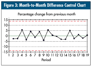

Figure 3 shows a control chart of the percentage of month-to-month change. Notice the average. What if management felt that things shouldn’t change more than 5 to 10 percent?
This is a totally worthless effort that is rampant.
