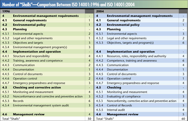

The dual goals of clarification and alignment required revisions and additions to the existing formal definitions. Sixteen of the resultant 20 definitions are new or changed.
Alignment with ISO 9001 created a more formalized structure and operation with additional documentation, linkages between parts of the EMS, performance measurement and detailed reporting to top management. Also, alignment provided greater emphasis on the Deming plan-do-check-act cycle for ongoing continual improvement of aspect-level performance. Greater consideration of legal and other requirements follows the ISO 9001 model. Recorded compliance review ensures adherence to intents for compliance, even during changes. Competency, by itself, is becoming a higher-profile topic, with the emergence of ISO 17024:2003 for competency-based personnel certification. These changes may seem innocuous by themselves, but they imply a larger story.

ISO 14001:1996 was exceptionally vague in some descriptions. (i.e.: “The organization shall establish and maintain an environmental management system.”) If you read it verbatim, an organization could claim that a requirement was satisfied with plans and that it was performing well, with very little evidence. There was nothing about a written system, little or no EMS training required, and little or no effectiveness review (either against what the organization claimed or against applicable laws). Typically, registrars provided enough detailed understanding and augmented requirements for registration to prevent many abuses under ISO 14001:1996 requirements.
In its current form, the standard states: “The organization shall establish, document, implement, maintain and continually improve an environmental management system in accordance with the requirements of this international standard and determine how it will fulfill these requirements.” Thus, there is a lot less “wiggle room” in ISO 14001:2004. Organizations will be required to know and to follow environmental laws, not only in their particular geographical area but also anywhere that their employees (including contract, agency personnel or even, potentially, suppliers) perform activities, or wherever their product may be shipped or used.
Additionally, while clause 4.1 is based on the specific stated requirements of ISO 14001:2004, many other clauses and sub-clauses also note “required by the environmental management system AND by this international standard.” This shows that the organization’s plans and the particulars of its EMS may affect overall or total requirements. In other words, the results of an organization’s environmental policy, scope, objectives and targets, plus its particular activities, products, services, customer base, location, structure and operational strategies can magnify the literal differences between ISO 14001:1996 and ISO 14001:2004. This directly affects the challenges of developing, implementing and maintaining the EMS. A simplistic comparison may fail to expose the most challenging requirements because they are not found in the standard. They arise from the resultant EMS.
