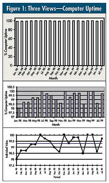

Figure 1 shows three graphs of the same data (percent computer uptime). The one at the top uses an origin of zero (which is more common than you'd think). The middle graph lets the program default to a scale. Contrast these with the run-chart analysis at the bottom: No trends, no runs of eight and nothing unusual about achieving 100 percent... merely luck. Common-cause strategy, anyone (matrix of downtime)?

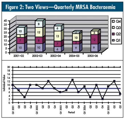

Figure 2 shows a stacked bar graph (top) with 19 "dots" that can, with little effort, be converted to a run chart (bottom).
The run chart tells the story quite well: Nothing's changed for five years, despite a lot of well-meaning improvement efforts. Similar to figure 1, would a matrix analysis of all 150 bacteraemias be helpful?

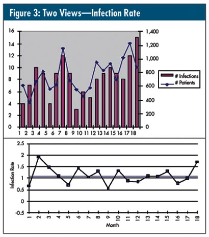

I've noticed that the "two-scale" syndrome seen in figure 3 is also very common. Note the differing left and right vertical axes. The horizontal axis is "time." This poster touted a profound change, but a run chart of the rate showed otherwise.
