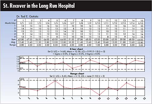

During the seminar in which Gotistic learned about charting, the instructor provided an example using 15 samples of five each, and Gotistic employs the same example when instructing the nursing staff. Illustrated below is the chart he uses in the class.
Gotistic created X-bar and R charts and was deeply involved in deriving control charts when one of the nurses asked why he'd selected a sample size of five. "Why not six or seven or even 10?" This nurse had, in fact, also participated in a seminar that offered an overview of SPC, and the instructor had used a sample size of five in that instance as well.
Gotistic had a ready answer, asserting that selecting a sample size of five was required for statistical precision, obliquely suggesting that any other sample size would be flawed in its statistical calculations. "Trust me," he said, "This is statistically sound."

Answer c is correct. A sample size of five allows for a shortcut to calculate the average. Five is the conventional sample size not because of its link to any statistical principle, but because it makes calculations more convenient.
By taking the sum of the samples, multiplying by two and moving the decimal point one place to the left, the same result ensues, as illustrated:
Moving the decimal one place to the left generates 12.4.
