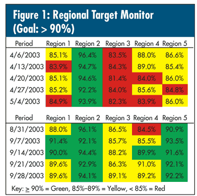

If you need further proof that government agencies can keep meticulous track of the unnecessary, take a look at the data in figure 1. This chart was sent to a government agency every week for monitoring an arbitrary target that had been set. There were 28 regions; for the sake of brevity, I've chosen five of them and given the first and last five weeks of data so you'll have an idea of what was presented at the meetings—for this particular week, a 26-by-28 matrix of numbers—and what received a reaction (no doubt with "little circles").

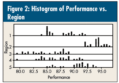

What might be a better alternative? Some of you might say, "How about a comparative histogram?" See figure 2: simple, obvious—and wrong. How do I know this? Because I "plotted the dots" to assess the processes first and found out that not all of them were stable, which invalidates this graph and would also invalidate any attempt to do an analysis of variance (ANOVA) using all the data.

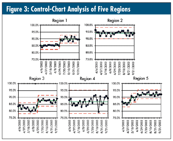

Figure 3 is so much better. An initial control-chart analysis was used to determine shifts, and the data are shown with their respective shifts. But more important , all five regions are on the same scale.
Note the difference of the histogram in figure 2 with the one in figure 4 that uses the most recent stable history (region 1—last 13 observations; region 2—all the data; region 3—last 13 observations; region 4—all the data; and region 5—last 13 observations). This, along with the control-chart analysis in figure 3, provides an excellent summary. The graphs say it all. By the way, did you notice that region 4's variation is approximately 2.5 times greater that of the other regions?
