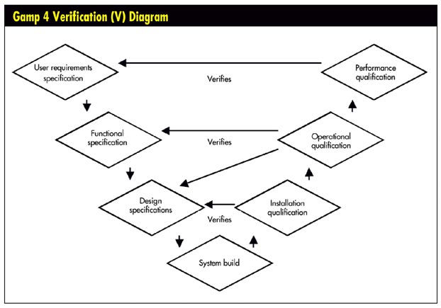

To prove that the system was implemented properly and is working as required and expected, the FDA requires that it be validated. To this end, it looks for documentation that the system, as implemented, meets the requirements specified in the URS as well as those established by the software vendor. As seen in the figure on page 31, the system validation itself is broken into three steps:
Installation qualification (IQ). This verifies that the software vendor's design specifications were accurate, and the installation was executed according to plan and expectations. IQ documentation includes the procedures for using the software, the hardware that the system runs on, details of the software version and the actual installation, and the library of documentation accompanying the software.
Operational qualification (OQ). This verifies that the software functions according to the vendor's specifications. The OQ addresses items listed in the FS and elements from the design specifications not covered in the IQ.
Performance qualification (PQ) . This verifies that the software meets the requirements and expectations established in the URS at the beginning of the selection process. Although the first two steps are generally the same for all companies installing the software, the PQ focuses on how the software is used in a specific context and tests how it performs in that context.
