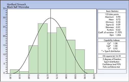

Armed with a histogram showing that, with a Cpk of 1.0, the process is barely capable, he mentions to his boss Rock deBote what a great job he’s done using the power of statistics to single-handedly improve the company. As he spreads out the histogram, deBote notices other statistics relating to the process, including a kurtosis of -0.62. Noticing his boss staring intently at the kurtosis figure, Simsack attempts to pass over the number’s meaning because he has no idea what significance it holds. “Of course the kurtosis is negative,” he says, shaking his head in dismay, “but my plan is to improve that by 100 percent.” Does this make sense in the ongoing improvement of the process?

As anyone who hasn’t fallen asleep in statistics class knows, kurtosis is a measure of the combined weight of the tails relative to the rest of the distribution. Sometimes it’s referred to as the “fourth movement.” The formula for kurtosis is:
A normal distribution has a kurtosis of zero and is known as “mesokurtic.”
On the other hand, if a distribution is tighter and taller than a normal distribution, the kurtosis would be a positive number. This distribution is referred to as “leptokurtic” because it has a long tail like a kangaroo.
Finally, for a distribution that is flatter than a normal curve, the kurtosis would be negative, or “platykurtic” with a short tail—like a platypus.
