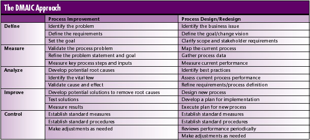

The Six Sigma approach incorporates five critical processes: define, measure, analyze, improve and control. An organization identifies a problem area, measures it, identifies its root cause, and then fixes and controls it.
Define. This step is concerned with defining project goals and boundaries, and identifying issues that must be addressed to achieve an improved sigma level (i.e., defect rate).
Measure. During this step, information about the current situation is gathered in order to obtain baseline data on current process performance and identify problem areas.
Analyze. This step focuses on identifying root causes of quality problems and confirming those causes with appropriate data analysis tools.
Improve. During this step, solutions are implemented to address the root causes of problems identified during the analysis phase.
Control. Here, the previous improvement phase is evaluated and monitored.

You must next decide on the required scope of improvement and whether to perform process improvement or process redesign. A comparison of the two choices is illustrated. Process improvement usually fixes a segment of a larger process, whereas process redesign involves building a new process to replace an old one. Initially, small to medium-sized businesses should begin by performing process improvement using basic Six Sigma methodology and then measure the results and quantify the savings.
