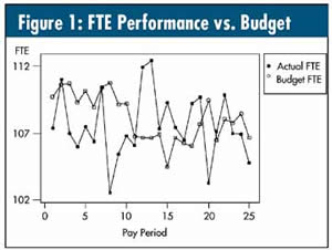

A graph I see over and over again is the simultaneous plotting of actual performance vs. budget--also known as a "mating earthworm plot." Figure 1 shows my friend's budget performance regarding her paid full-time equivalent (FTE) time. Note the recent string of 10 out of 11 periods above budget, although she exonerates herself because the last three periods are below budget.
How much of your time is spent at meetings where performance-vs.-budget graphs like this are presented? Or bar graphs, stacked bar graphs or crazy-making tables titled "This Month," "Variance to Budget ($)," "Percent Variance," "Last Month," "12 Months Ago," "Year-to-Date" and "Year-to-Date 12 Months Ago"? When people at these meetings start drawing little circles, and others start covering their tails, leave.

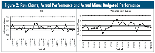

My friend knew better than to try to fool me, so I asked her for the data. I plotted the two run charts seen in figure 2. The one on the left is a run chart of her actual performance, and the other is a plot of this actual performance minus the budgeted performance.
Her process was perfectly designed to get the results it has always gotten.
How can this make sense? What about the special cause in the graph on the right (observations 12–19 above the median)? Well, there was a process change… of sorts. (More about that next month.)
