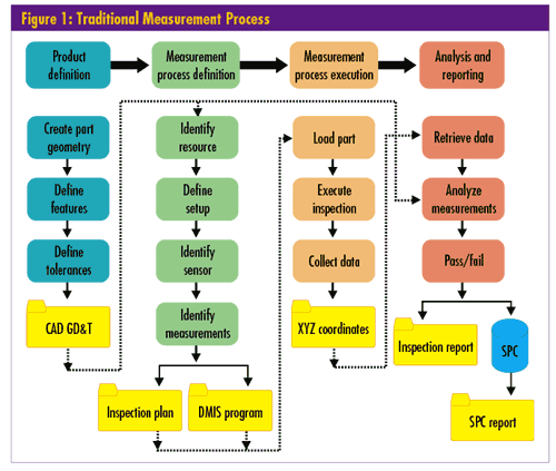

A traditional 3-D measurement process performed with a coordinate measuring machine (CMM) can be summarized by the flowchart seen in figure 1 below. Note the key elements:
Product definition. This is the stage at which part geometries, features and tolerances are defined. The output is a 3-D computer-aided design (CAD) model, complete with dimensions and geometric dimension and tolerancing (GD&T) information.
Measurement process definition. This step identifies the measurement equipment and sensors that will be used to make the measurements, how they will be set up and which characteristics will be measured. The end result will be an inspection plan, operator work instructions and, in the case of automated inspection, an automated inspection program for a CMM or similar device.
Measurement process execution. The CMM measures part features and outputs the x, y and z coordinates of each measurement.
Analysis and reporting. Finally, the measurements are analyzed and compared to the specification limits. The part is determined either to have passed or failed the inspection. All relevant data are then output as a report and, possibly, as input into statistical software for further analysis and trending.
Although the number of key characteristics to be measured varies, this workflow is based on identifying and measuring these characteristics, and providing an analysis report of the resultant data.

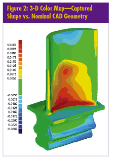

DSSP software quickly performs a 3-D comparison of the captured shape against the nominal CAD geometry and displays the results on a computer screen using color maps, such as the map depicting a turbine blade in figure 2 below.
Areas whose color departs from green are those where the actual geometry departs from the nominal geometry. The darker the red, the further the measurement deviates from the nominal geometry in a positive direction (more material), which ultimately will result in a wider blade. Conversely, the darker the blue, the further the deviation from the nominal geometry in a negative direction (less material), thus resulting in a thinner blade. The above analysis can easily be achieved, typically in less than 30 minutes, including setup, scanning and analysis.

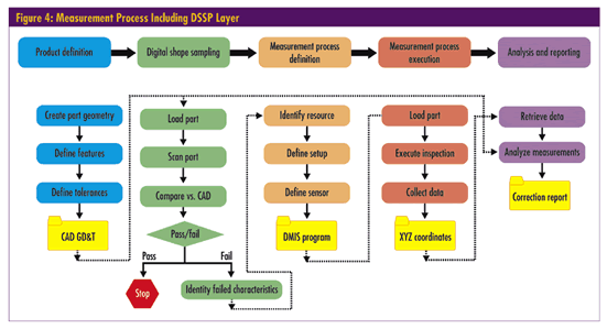

How can modern measurement techniques use these advantages, merging them into an efficient, faster and more economical measurement process? Rather than measuring all characteristics, the process should measure and analyze only the characteristics that are needed, i.e., those critical measurements that are out of tolerance and need to be corrected either by changing the process or remachining the part.
With this approach, the traditional measuring steps are rearranged to add a DSSP layer. Compare figure 4 below to figure 1. Note that the main difference between the two processes is the addition of the DSSP column that defines how the entire part is quickly scanned and compared to the CAD model. If the part is out of specification, it can move along in the measurement process using whatever measurement device is appropriate, but measuring only those characteristics that are out of tolerance. This results in a faster time to market and a cheaper inspection process.
