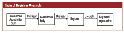

1. Are you accredited by a signatory to the International Accreditation Forum?
Accreditation is the registrar's quality assurance. It ensures that the registrar is following the necessary protocols and adhering to sound business habits. An accredited registrar is audited regularly by the accreditation body, just as your company might be audited. In the United States, the national accreditation body is the ANSI-ASQ National Accreditation Board (ANAB). Robert King, ANAB's president, states that most credible accreditation bodies are signatories to the IAF, which provides oversight and quality assurance to the accreditation body. This chain of oversight is detailed in the figure below.
