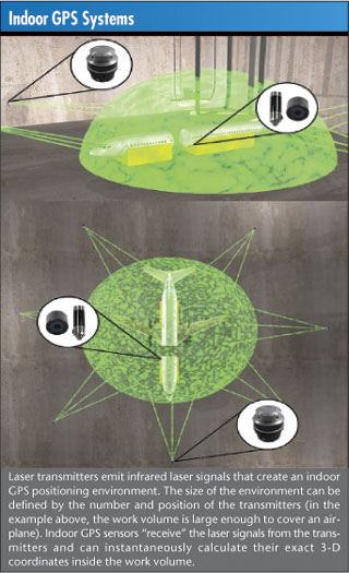

Mention the term “GPS” to the average person and most will associate it with small devices that read satellite signals and can provide surveillance or driving directions. However, an exciting new system known as indoor GPS is now being used by many manufacturers to perform large-scale measuring and alignment tasks. Indoor GPS doesn’t use satellites; instead, it works by installing an array of infrared laser-pulse transmitters around the object to be measured. These objects are generally large manufactured items such as parts and assemblies for aircraft, automobiles or ships. Sensors pick up the signals from the transmitters, and calculate angle and position based on the timing of the arriving light pulses. An amplifier converts the analog signals into digital pulses, and a receiver converts the pulses into angle data. Indoor GPS network software processes the angle data into highly accurate position information and then makes this information available to the client network, whether on the shop floor or off-site. Because the number of transmitters that can be used is practically unlimited, the size and shape of the work area can be fully defined by the user. For large assemblies, more transmitters means that measurement, inspection and alignment can be performed accurately and without having to move or reset equipment. This flexibility is the key to the utility of this technology.

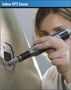

Indoor GPS can provide cost savings in the millions of dollars for large manufacturers by helping them move away from jigs and toward a virtual alignment process in which parts are precisely located and mated within the factory. Sensors can be placed on a wing, for example, and the movement of that wing can be precisely tracked as it’s slowly being aligned with the fuselage that it will be riveted to.
“Much like you can track your car moving outdoors on the planet’s surface using satellite-based GPS, now you can track the motion of that wing in real time, to very high levels of accuracy within the factory,” says Barrientos. “At the same time, you’re doing the exact same thing with the fuselage.”
