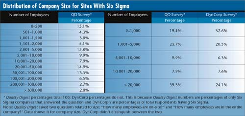

Despite plenty of press, anecdotes and even surveys showing huge Six Sigma successes, fewer than one-quarter (22%) of all companies we surveyed have a Six Sigma program in place. Ninety percent of the companies that do implement Six Sigma are units, divisions or sites of larger organizations. Of those, three-quarters belong to organizations with more than 2,000 employees.
According to 1997 U.S. Census Bureau statistics, 98 percent of U.S. firms had fewer than 20 employees, and 82 percent grossed less than $1 million in sales in 1992. More than 30 percent of all sales or receipts for U.S. companies come from companies with fewer than 100 employees. If Six Sigma is truly yielding huge savings for the companies that use it, then it stands to reason that small businesses need Six Sigma in order to achieve the kind of cost savings and increased profitability enjoyed by large-company Six Sigma practitioners. By extension, this would aid the U.S. economy as a whole.

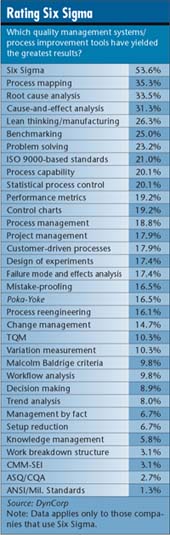

Attrition

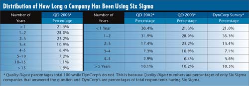

Our 2001 and 2002 surveys and the DynCorp survey show a drastic drop in the percentage of companies using Six Sigma after the second or third year, as shown above.
There are several possible explanations for the drop. The first is that although Six Sigma has been around for a while, it has only gained mainstream popularity within the last few years. This is due to press coverage of Six Sigma successes at giants like GE and Motorola and the millions of copies of books on the subject sold by Chowdhury, Harry and others. What we could be seeing is the ramp-up of Six Sigma adoption.
Another explanation is that companies are abandoning the program. Not tying Six Sigma projects to corporate goals and/or not leading the Six Sigma initiative by top management almost guarantees the program will fail, say our experts.

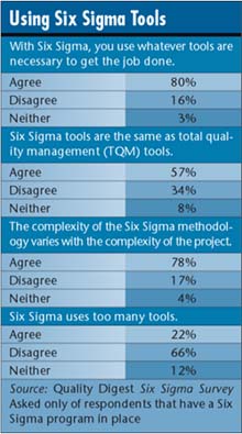

Another issue is that companies often view Six Sigma the same way they view traditional quality control programs: as a set of tools you use to solve a particular problem.
"Some companies define Six Sigma as a quality metric--the goal of 3.4 defects per million," says Linsenmann. "In such a company, Six Sigma is a technology and therefore run by technologists. By contrast, at DuPont it's how we do our work. It's the vision we're working toward. We have to continually refresh and expand the domain to make it relative to everyone."
For companies that see it as only a cost-reduction method for manufacturing, Six Sigma won't survive. Once they wring the maximum amount of improvement out of a set of tools, the company will give up. The key is to look beyond simply solving a particular problem.
