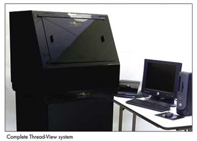

Technology has advanced to the point that these limitations can be overcome through the use of vision-inspection technology. The Johnson Thread-View System Model 3620 is an example of a system that works independently of the operator, as seen in the images below.

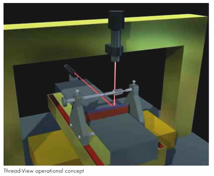

In such a system, the thread is held between two adjustable arbors on a stage that can travel in the X or Y direction. A collimated light source, seen in back in the image at the bottom of page 22, is reflected off of a mirror just below the thread. The lens and camera system, just evident in the top of the image, captures the resulting back-lit image and transfers it to the computer. All of these components rest on a vibration-resistant base and bridge subassembly. The physical dimensions of the system shown here are approximately 36 in. × 36 in. × 40 in., with a weight in excess of 650 lb. The mass is required to dampen any floor or acoustic vibration in the surrounding environment.

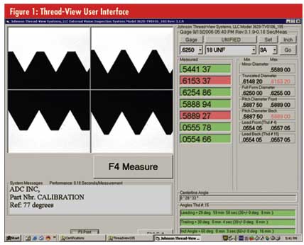

This noncontact system works in a Microsoft Windows environment. After loading the component between the arbors, the operator uses a mouse to select the thread size, pitch and class from drop-down menus on the main screen (as seen in figure 1 above). The minimum and maximum tolerances are automatically populated. When the cycle is complete, a green light indicates that the measurement is within specification, and a red light indicates that the parameter is out of tolerance. A certification is automatically generated and electronically stored.
The benefits of systems of this type fall into three general categories:
1. By removing the human element from the measurement process, errors attributable to bias (e.g., "What was the measured value last year?"), feel (e.g., "That seems about right") or transcription problems (e.g., the measurement indicates 0.4545 in. but 0.4554 in. was recorded) are eliminated. Measured values are inherently more accurate and repeatable.
2. For calibrating set and work plugs, a user can meet ASME requirements in approximately two minutes. Verifying the dimensional conformance, including exact values for each thread characteristic, can be accomplished for a fraction of current costs. This requires minimal training and allows a quick cycle time, presenting tremendous savings.
