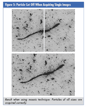

Cross-field particles
When acquiring images of small particles with the appropriate r esolution, it's inevitable that only a part of the sample is captured by the camera image. As a result, particles are cut off at the edge of the image, particularly where large particles are concerned. (See figure 5.)
Today, these problems can be solved with mosaic images. The sample is automatically moved via a motorized stage, and single images are acquired in each position. These single images are then put together to form a large overall image. This solves the problem of particles being cut off as long as the movement of the stage is accurate enough. Theoretically, the stage reproducibility should be better (i.e., a lower number in microns) than the pixel scaling. A typical value for this reproducibility is approximately 1 µm, which is sufficient for the pixel scaling seen in figure 4. What can you do if this isn't enough? There are two possibilities. Either use a motorized stage that's more accurate (and much more expensive) or use a stitching algorithm, which recalculates the correct positions of the different images relative to one another. The disadvantage of a stitching algorithm is time. You must acquire images with an overlap factor and subsequently do the stitching. This is the reason why most people avoid using software stitching, if possible.
