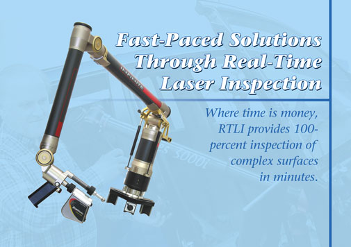

How RTLI works
The RTLI system discussed here is built on four pieces of state-of-the-art technology:
A Romer CimCore portable CMM (or PCMM), also called an articulated arm
A Perceptron Inc. laser scanning probe
PowerINSPECT point cloud processing software from Delcam Inc.
A top-of-the-line laptop computer
The PCMM locates the probed points in 3-D space and can measure to ±16 mm, depending on the size of the arm. Together, a PCMM and laser probe system can measure to ±66 mm (combining scanner and PCMM accuracy).
The laser scanning probe, attached to the end of the PCMM arm, can gather between 15,000 and 25,000 points in 3-D space per second with an accuracy of 50 mm or fewer. Probing is done at rates of 15 to 200 scan lines per second, and each line contains hundreds of points. Employing leading-edge technology, these devices are far advanced over earlier generations of scanners primarily used in reverse engineering.

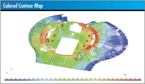

RTLI weather maps
RTLI inspection software generates colored contour maps, sometimes called “weather maps,” which reveal the precise topography of a surface by comparing it to the CAD file from which it was generated. The maps show errors, deviations from specifications and the relative distance of any point on a surface from the edge of the CAD nominal.
The software then maps the errors in an intuitive color scheme. Green is for points in tolerance, red for points out of tolerance on the plus side and blue for points out of tolerance on the minus side. These displays show the corrections needed to maintain tolerances and specifications, a vital process control capability.
RTLI color weather maps are invaluable for troubleshooting and quickly searching out root causes. When the forming surfaces of tools, dies and molds are questioned, the need for inspection goes far beyond touch probe dimensional measurements. Once the tool’s alignment and orientation have been verified dimensionally, RTLI can zero in on the key surfaces of any inspected product.
