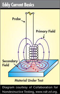

If you apply an alternating current to a wire wrapped around a conductor (e.g., the wire in an eddy current probe), an alternating electromagnetic field forms around the conductor. Bring this field into proximity with another conductive material--a pipe, pressure vessel, area of aircraft wing, etc.--and an alternating electrical current will flow in that portion of the material as well. This alternating current causes its own secondary magnetic field that interacts with (i.e., adds vectorially to) the primary field and results in a perturbation to the field around the probe, as illustrated on the right.
As long as there’s no change in the material or its proximity to the probe, the perturbation remains constant and can be measured. If while moving along the material under test, the probe passes over a crack, a region of corrosion, an overstressed area, a hole or some other anomaly, a subtle change in the field occurs. This change can be measured and compared to measurements on a similar known-good material and the results quantified by the operator and the eddy current instrumentation.
Because the response to the magnetic field depends upon the material’s conductivity, magnetic permeability and distance from the probe to the material’s conductive surface, eddy current testers can gather information in addition to the location of flaws or corrosion. For example, they can provide information about the physical properties of the material or the thickness of nonconductive coatings, such as paint. If the material isn’t too thick, eddy currents can also measure thickness.
Changing the frequency of the probe’s excitation current changes the depth to which the probe can penetrate: the lower the frequency, the deeper the measurement. Thus, a low-frequency eddy current instrument can detect subsurface defects or defects on the opposite side of the scanned material. This makes eddy current testing ideal for detecting corrosion or cracks in areas invisible from the surface. Often, measurements are made at multiple frequencies in order to inspect the material at multiple depths.

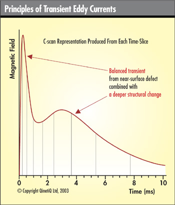

A new technology, pulsed (or transient) eddy current, uses a shaped waveform rather than a continuous sine wave to excite the coil and generate an eddy current pulse in the structure. Because a pulse represents the sum of sine waves for a broad band of frequencies, one test pulse can contain all the frequencies needed to perform the tests at different depths, explains Marcus Johnson, associate scientist with the Center for Nondestructive Evaluation at Iowa State University. “The real advantage is that pulsed eddy current is rich in low-frequency components so you’re able to see near-surface and deeper flaws at the same time,” he notes.
Iowa State’s pulsed eddy current probe is excited by a pulse, which generates a broadband eddy current field in the sample. The higher-frequency eddy current components are generated more quickly within the material under test and lead to a rapid, high-amplitude response, as seen by the probe, says Johnson.
If you look at the pulsed eddy current response as a function of time, the waveform’s earlier portion corresponds to near-surface artifacts such as liftoff. The middle portion corresponds to midsample artifacts such as internal cracks or interlayer corrosion, and the tail end of the waveform could indicate overall thickness or show bottom surface artifacts such as corrosion, as illustrated below.
Pulsed eddy currents offer an advantage over multiple-frequency probes because users don’t have to select the frequencies at which to scan, says Robert A. Smith of the United Kingdom-based QinetiQ Ltd.
“The basic difference is that transient eddy current captures data covering all the frequencies in the bandwidth, whereas multiple-frequency eddy current only captures certain specific frequencies,” says Smith. “This means that the optimum frequencies for any part of the structure will always be available from any transient eddy current scan. For a multiple-frequency scan, the optimum frequencies would be determined in advance and will be different for each different structure, requiring several scans over complex structural changes.”
